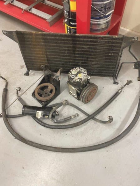

BDuck 14 Posted April 3, 2023 I may have found a complete condenser, compressor, bracket & hoses at a price I'm willing to pay even if they need reconditioning Share this post Link to post Share on other sites
BDuck 14 Posted April 3, 2023 what I'm looking at 1 SPArKy_Dave reacted to this Share this post Link to post Share on other sites
SPArKy_Dave 9,344 Posted April 3, 2023 1 hour ago, BDuck said: what I'm looking at Yep, that's definitely an XD condenser core. I'd grab them, if reasonably priced. Does it come with the firewall TX valve, Evaporator core (in-dash) and electrical parts too? - temperature switch, AC switch etc. Share this post Link to post Share on other sites
BDuck 14 Posted April 3, 2023 Listed as XC XD XESent from my Pixel 6 Pro using Tapatalk 1 SPArKy_Dave reacted to this Share this post Link to post Share on other sites
BDuck 14 Posted April 3, 2023 Also only comes with whatever is in the picture. My mechanic is currently sourcing stuff for me so I'll run it past him and see if it's worth it.Sent from my Pixel 6 Pro using Tapatalk 1 SPArKy_Dave reacted to this Share this post Link to post Share on other sites
SPArKy_Dave 9,344 Posted April 3, 2023 Just now, BDuck said: Listed as XC XD XE Sent from my Pixel 6 Pro using Tapatalk It's definitely an XD condenser core. XE ones have a different piping configuration, and the XC cores are much longer/narrower. Share this post Link to post Share on other sites

BDuck 14 Posted April 20, 2023 Little update, just picked up what's in the pic above for $50Sent from my Pixel 5 using Tapatalk 2 SPArKy_Dave and deankxf reacted to this Share this post Link to post Share on other sites
